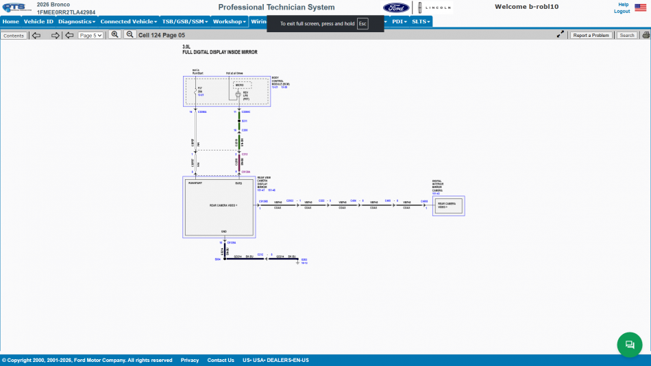

Hi All,
I think the next step here is to check the C212 A Pillar connector for existing circuits, If these circuits are not present then this modification will be very extensive and would require changing the dash harness.
If we look at the topography of the DRVM system we can see 2 circuits leading back to the Body Control Module via Connector C212

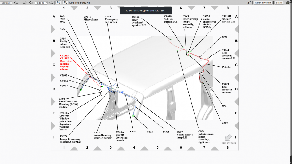

Here is the how the Roof Section of that harness is routed

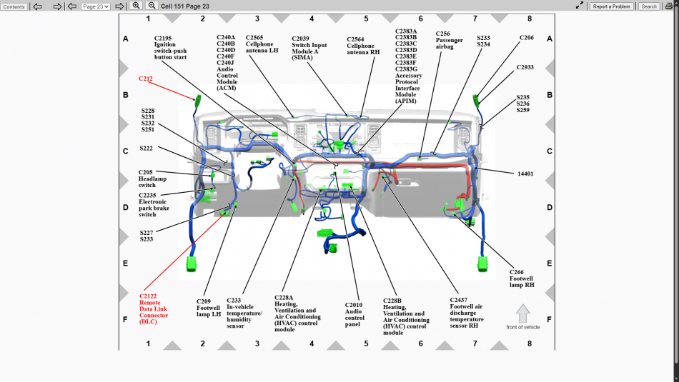

And here is the Dash Side of that connector behind the A-Pillar trim
We would be looking for Pin's # 1 & 2 within this connector, See the attached PDF and please let me know what you find. In the best case scenario here we would need

Got it, So that is part of the panel assembly. Id like to check this with your VIN but I believe this is it
- Benny
Yes, that’s it but I really did not expect that panel to be near a thousand dollars!! Holy cow!! I was really hoping that part was available separately. Might have to try and fix it myself again considering the cost of having to buy the whole panel at that price. But thanks for checking though.
